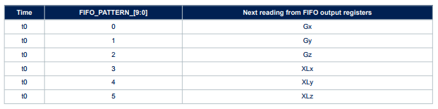

It is strange, can you check the content of the FIFO_PATTERN_[9:0] bits in the FIFO_STATUS3 and FIFO_STATUS4 registers, to see if there are accelerometer and gyro data.
2018-11-05 9:11 AM
I checked the FIFO pattern, and the accelerometer and gyro data are included. However, when I check the gyro x and gyro y registers directly now, I also get zeros. So there may be something wrong with the gyro configuration? My apologies for not catching that earlier.
