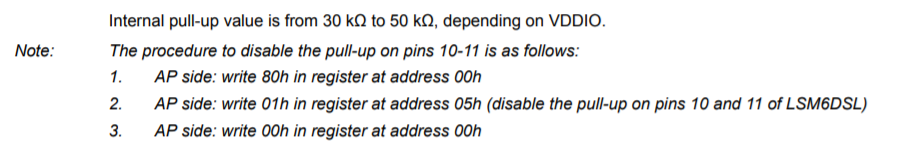

Hi @Slong.1 ,
my first guess is that the extra power consumption could be coming from the hardware connections of LSM6DSL pins.
Can you please check pin 10 and pin 11 configuration? They should be left unconnected. Otherwise, as reported in the datasheet, p.47, they have:
In addition, are you using SPI or I2C protocol?
