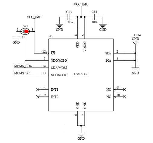

We are using the LSM6DSL sensor in a custom PCB, we are also using the X-CUBE-MEMS extension drivers to communicate with the MEMS sensor. The image below is the schematic part of the LSM6DSL. VCC_IMU being 3v3, W1 is closed with a solder jumper to VCC_IMU, the microcontroller is also powered at 3v3 and the I2C logic signals are 3v3, the Pull-Up resistors are 4k7 each one, the bus is running at 100000.

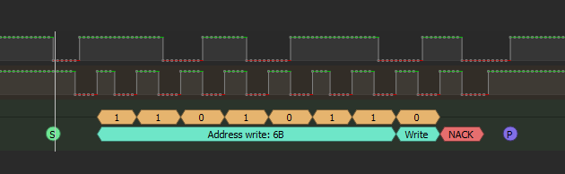

When trying to use LSM6DSL_Init, LSM6DSL_ACC_Enable or LSM6DSL_GYRO_Enable the IMU replies with an NACK. Here is the logic analyzer capture of the microcontroller trying to communicate with the IMU.

  • Besides of wiring CS to logic high, do i need to do anything else to configure the LSM6DSL to use the I2C bus?

I just realized that the MEMS sensor isn't replying at all.

hi carlos, could you share the logic analyze capture? please consider that the CS, and not the CS* as in your schematic, should be high, so CS* should be low to activate I2C... regards

Which CS you mean? As far as i know the /CS of my schematic should be high to be in I2C or low to be SPI mode.

Here's the logic analyzer capture:
The SDO/MISO line is set to logic 1, /CS is also set to logic 1.

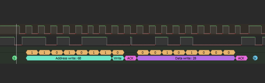

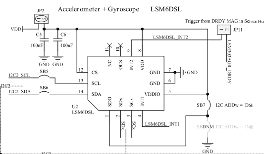

Here's a capture of the I2C bus of the x-nucleo-iks01a2 dev board, which have the same settings:

hi carlos, thank you for the sharing.  Yes, I was wondering why you put CS* in inverse logic instead of CS only, as in X-nucleo-iks01a2.

Hi, it's just the symbol graphic.

Yes, actually i plugged the I2C bus of the X-NUCLEO-IKS01A2 to my custom board and i'm able to identify and get data from that IMU, and also i can identify and read the sensor data from my custom board IMU (now SDO is set to logic low to don't collide with the X-NUCLEO-IKS01A2 IMU address), so i think is matter of coupling.
