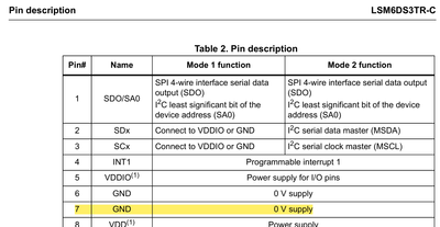

Pin 7 is missing, it should be connected to GND. Perhaps it's just hidden. Otherwise, looks good.
See if you can see SDA/SCL on a scope. If you're using STM32/HAL, not that the slave address should be left-shifted one bit.
