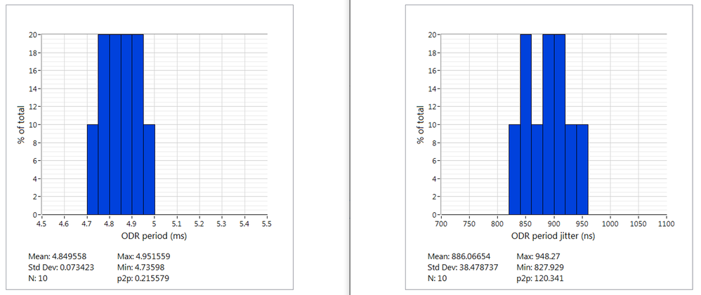

These information are not publicly available, in the sense that these parameters are not reported in the datasheet. However, I can share you some characterization lab data on a representative sample, but you must assume them to be a typical value (with no production limits).

Great answer: no marketing blurb, but usable engineering info!
