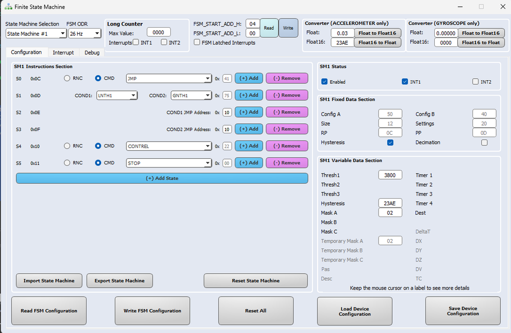

I'm trying to move Finite State Machine config from devkit using Unico GUI to final application. I've prepared movement wakeup example from FSM datasheet in Unico, which is working totally fine on devkit, it could even detect knocking in desk.

I'm attaching both .fsm and .ucf files which are working fine on devkit.
