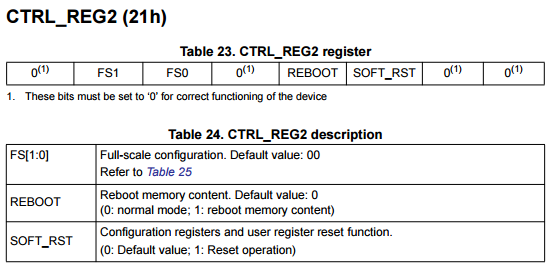

I don't have any experience with this kind of issue, but I can imagine the principle of this failure. The sensor loads calibration constants during start-up to volatile memory, I think, the voltage drop can cause that the data are corrupted in the memory and the the output values are wrong. When you restart the sensor it loads the calibration constants again and works well then.
There is possibility to do reboot of memory content, writing ''1'' to REBOOT bit in CTRL_REG2.

So, a refrigerator magnet can degrade the zero-gauss offset and this is permanent until a reset I suppose. Can we do this reset in software by calling REBOOT?
Is this a safe procedure, meaning that every time a saturation happen we should reboot the sensor?

I don't have any experience with this kind of application, but I discuss it with my colleague and he would not recommend to use the sensor for this kind of application. Strong magnetic field can significantly degrade the sensor performance. He also told me that SW reboot will probably not help, only power cycling should solve the sensor freeze, of course you can try the SW reboot in your particular case.
