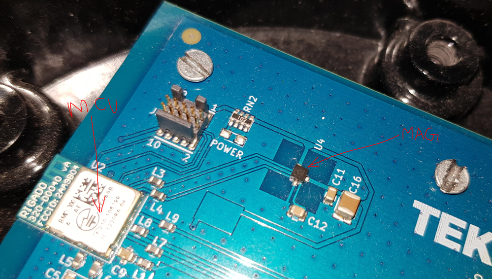

We are using LIS3MDL in our product to detect cars. Most of the times the magnetic field values are stable. We are using adaptive baselining to derive the baseline field. However we have observed that on an ad hoc basis the magnetic field values suddenly varies significantly even when there is no external influence. As a result of this we get a false positive that a car is present. What could be the reason?

2019-10-31 5:52 PM
Hi Eleon...one more thing that I thought to share with you....the MCU uses a DC-DC converter which is built inside the module. Would this cause this issue?
2019-10-31 5:53 PM
Distance between MCU and MAG is 23mm
2019-11-12 3:12 AM
Hi @AMans.1053 , the MCU and magnet are quite close, but anyway safe... Is it possible for you to synchronize the magnetometer acquisition and DC-DC converter action in order to check if the issue can be related to a cress-talk between the two chips? Regards
