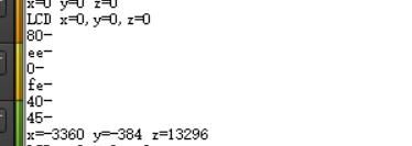

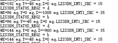

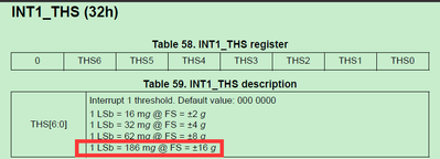

1. LIS3DH full scale is 16g, And it works in normal mode. The trigger threshold is set to 30, and the actual acceleration trigger value is 30*186mg = 5580mg. But when the trigger interrupt occurs, the output register is read and the output acceleration value is less than 5580mg. I think it should be greater than 5580mg. When the threshold trigger occurs, will enter the data processing function (void DealAccData(void)) ,the debug log is shown in the following figure:

DEBUG_PRINT("LIS3DH_STATUS_REG2 = %x\r\n",st);
uint8_t reg2;
lis3dh_gvReadReg(LIS3DH_INT1_SRC,®2);
lis3dh_gvGetAccData((int16_t *)&Var_giXMaxAcc,(int16_t *)&Var_giYMaxAcc,(int16_t *)&Var_giZMaxAcc);
DEBUG_PRINT("@X=%d mg,Y=%d mg,Z=%d mg,LIS3DH_INT1_SRC =
%x\r\n",Var_giXMaxAcc,Var_giYMaxAcc,Var_giZMaxAcc,reg2);

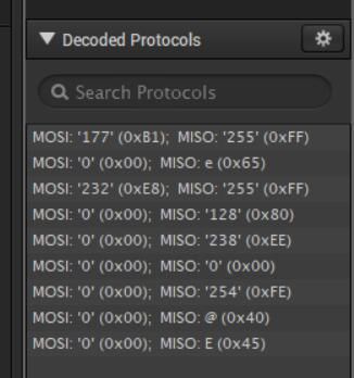

This is the captured SPI bus data and the data printed by the device
