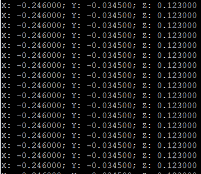

However, I noticed that the values I read from the sensor remain almost always the same and do not update as expected, as shown in the photo below.
Could anyone help me understand what might be causing this issue or guide me on how to troubleshoot it?

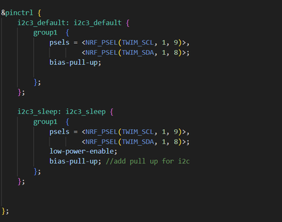

About the pull-up, I enabled the software pull-up.

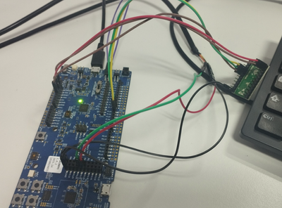

Regarding the schematic, you can also find the related figure attached.
For the ST example, I didn’t make any modifications. I simply used the same configuration and then read the XYZ data. However, the data is always repeated, as shown in the figure.
One thing I noticed is that if I reboot the board sometimes (power off/on), I get new data values, but then those values remain repeated again until the next reboot.
I hope my response clear.
Thanks a lot for your help.
I appreciate your efforts.
@ASREB wrote:
About the pull-up, I enabled the software pull-up..
You mean the internal pullups - inside the STM32 or the nRF ?
These are unlikely to be suitable for I2C - their value is too high.
Again, have you looked with a scope to verify that you have good signals on the I2C wires?
@ASREB wrote:
the data is always repeated, as shown in the figure..
Again, what are you doing that would make it change ?
Have you used a logic analyser to see what's actually happening on the wires ?
ie, is the sensor itself sending constant data, or is your software just ignoring updates ?

I checked I2C and another fature....
I found the issue but I don't fully understand how to resolve. Just to more explain u, I am working with an nRF5340 board and the LIS2MDL sensor. When I reboot the board to retrieve the X, Y, and Z magnetic values, I always get exactly the same values, even after rebooting multiple times. While investigating the problem further, I noticed something strange: when I disconnect the UART pins, the values li2mdl change. Each time I connect or disconnect the UART pins, the sensor values update.
You still haven't said what pullups you're using !
As noted, correct pullups are critical to correct & reliable operation of I2C.
Do you see the same behaviour on an ST board ?
How, exactly, do you "connect the UART pins" ?
Bizarre behaviour like this is often due to poor connections; particularly poor GND and/or VDD connections - see this post.
Again, have you used an oscilloscope to see what's actually happening on the wires?
