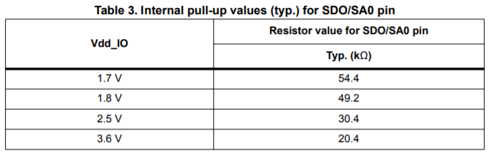

Hi @党军 �?� ,
Let me please better understand the point.
Are you using the I2C protocol for the communication right?
How did you set the SDO/SA0 pin at hardware / firmware level?
Please note that this is pin has Internal pull-up, and if you are connecting it to the GND layer you have to take into account of the consumption coming from the pullup resisters (see datasheet, p.9):
Or otherwise, you should tie the SDA/SA0 pin to Vdd or disconnect it.

2021-09-20 12:10 AM
Try with pulling SDO/SA0 up to Vdd, and then check the consumption.
-Eleon
