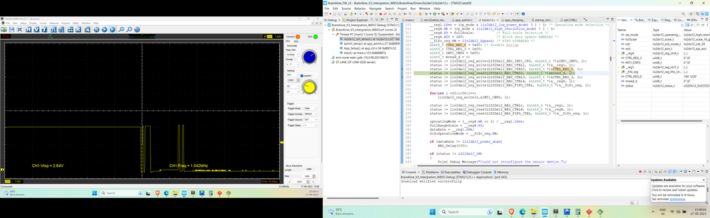

I am also getting some issues in writing the register as you can see in the screenshot of the scope.
In this screenshot i am writing some value in the register. and in the left side you can see the scope this is the MOSI pin

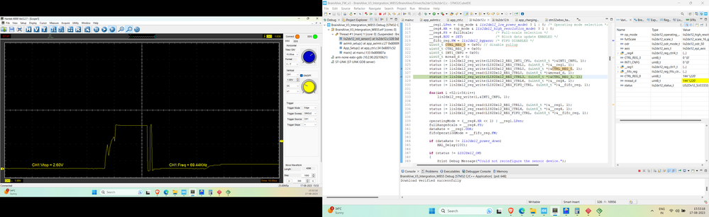

This is the status of MISO pin. In this screenshot i am reading the register which i have written but i am getting different value on reading

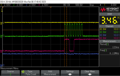

Last year you shared this picture:

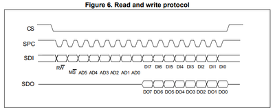

Here it looks you are working in SPI mode 1 (CPOL=0, CPHA=1), but the device works in SPI mode 3 (CPOL=1, CPHA=1), with the clock polarity in idle state at Vdd and the CS line that must switch from high to low state just before stating the clock toggling (16 clock pulses).
