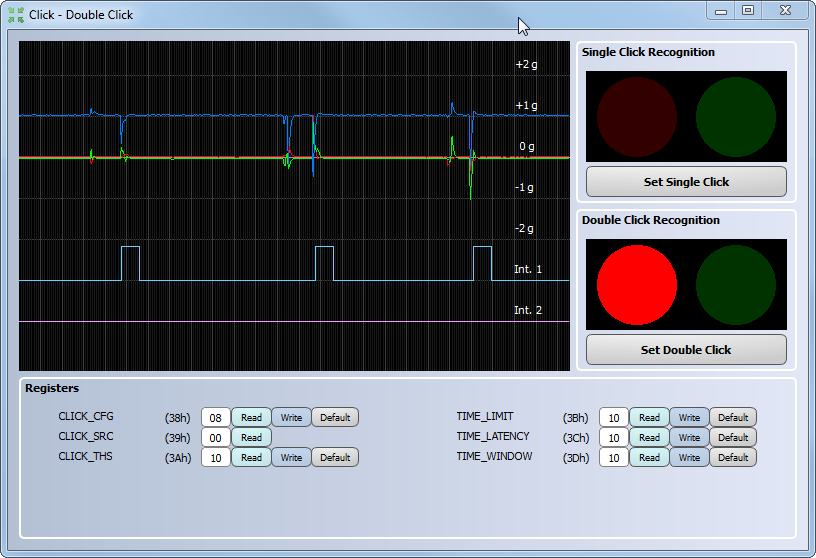

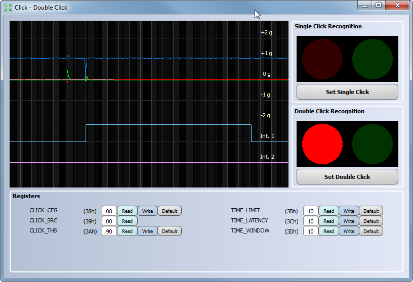

Here is my working setup (ODR=50Hz), just for reference:
LIR_Click bit = 0:
LIR_Click bit = 1, Interrupt is cleared after CLICK_SRC read:

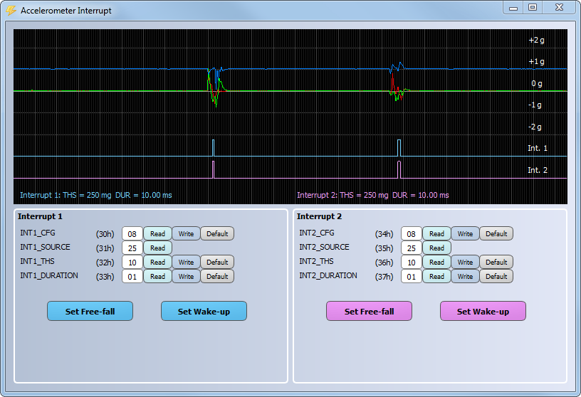

Posted on January 05, 2017 at 18:21
I suppose you are not talking about double click configuration but about simple threshold interrupt now. I would need to know complete configuration of your sensor and also orientation of your sensor in consideration of gravity. I can check it, maybe I will see some problem. Please also double check all registers related to interrupt generator settings and linking interrupt generator to INT pins.
Here is an example of simple interrupt settings:

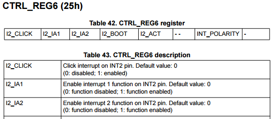

Posted on January 09, 2017 at 18:00
What is your setting of CTRL_REG6 register?
There should be 0x20 to activate Interrupt generator 2 on INT2 pin.
Please be aware that the device has two independent interrupt generators which can be linked to INT1 or INT2 pins.
Posted on January 09, 2017 at 20:29
OK, Chithambaram.
Then I don't know where is the problem. If you see the interrupt is triggered (based on INT2_SRC value) and the interrupt generator is connected to INT2 (CTRL_REG6 = 0x20), you should see the signal on the pin.
To aswer your previous question, the interrupt pins have push-pull outputs, so pull-up is not needed.
