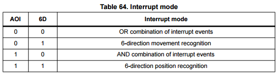

I'm afraid that the LIS2DH12 is not suitable for your application. You would need to use accelerometer with low-pass filter, for example
http://www.st.com/content/st_com/en/products/mems-and-sensors/inemo-inertial-modules/lsm6dsl.html
. You can check thehttp://www.st.com/resource/en/datasheet/lsm6dsl.pdf
if it suits your needs.Just to clarify LIS2DH12 has three interrupt modes:
