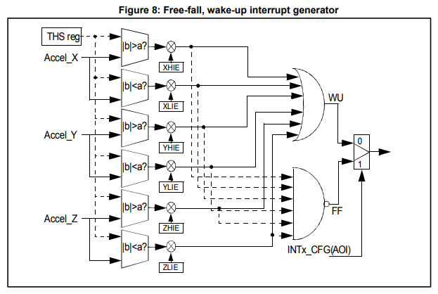

Hi John, you can refer to the application note for ST MEMS accelerometers, AN3308. I'm supposing you would like to implement the sleep-to-wake-up (and return to sleep) function. In this case, at p. 20 the Interrupt generation has been described, while the wake-up procedure is described in paragraph 6.3 (pp.23/24). AOI is a flag for an And/Or combination of Interrupt events, and works as in the picture below (same pages).
