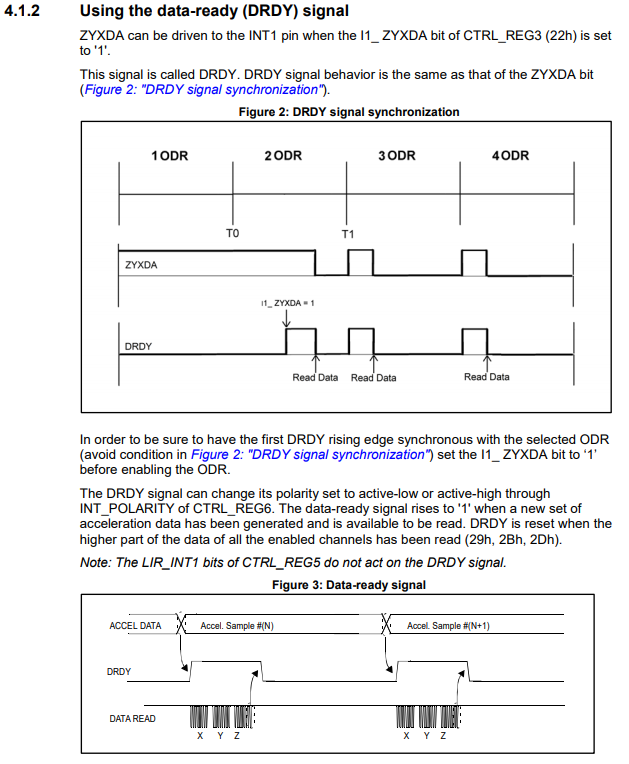

Hi Kim, it seems you did well in your code. How is the DRDY connected to the MCU?
Please also check carefully if you did everything is described here below. Regards
