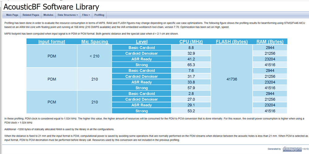

2021-02-05 4:56 AM
Hi @Király Béla ,
the maximum allowed distance is 21.2mm (so the maximum value allowed in the mic_distance variable is 212).
Our experts confirm me that this is also the optimal measure for which ST library has been calibrated.
For a more reasoned choice between PDM and PCM, you can refer to the table below:
If you control PDM clock, you have to pass also that parameter to the library
Otherwise, it would be better to use ST PDM2PCM library and run the BF in PCM mode.
-Eleon
