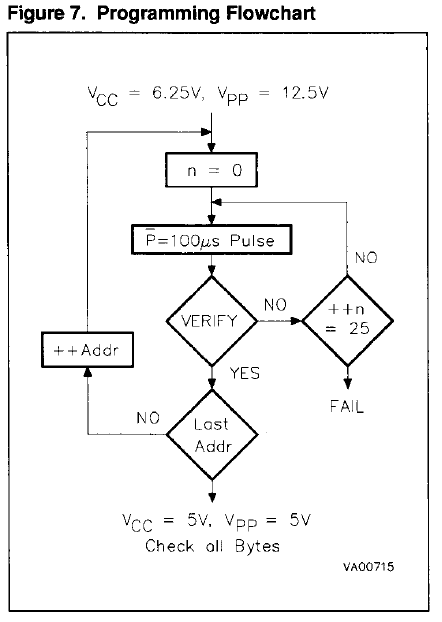

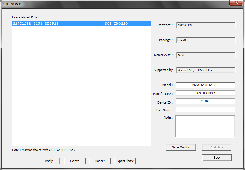

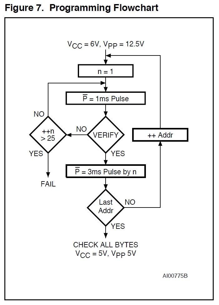

It looks like the electronic ID is 20 89. Here's a screenshot of the profile I made in my programmer software.
I chose 13.00V for programming, 6.50V for Vdd Write, and 5.0V for Verify which was close to the specifications from the "A" device, see screenshot from datasheet. Does that seem right?
2021-09-01 11:17 AM
That's the code for the NMOS M27128A, the CMOS M27C128A was 0x20,0x0A
That wants 6.00V
2021-09-01 11:27 AM
Longer programming pulse, lower VCC
Overall the part seems slower, so it could well be someone got inventive and tested/binned the faster ones
