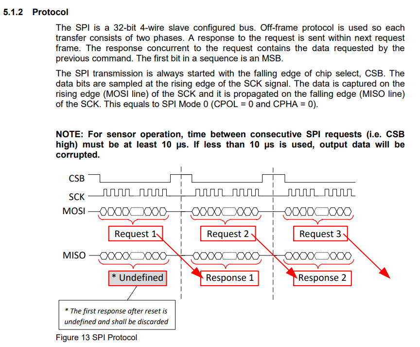

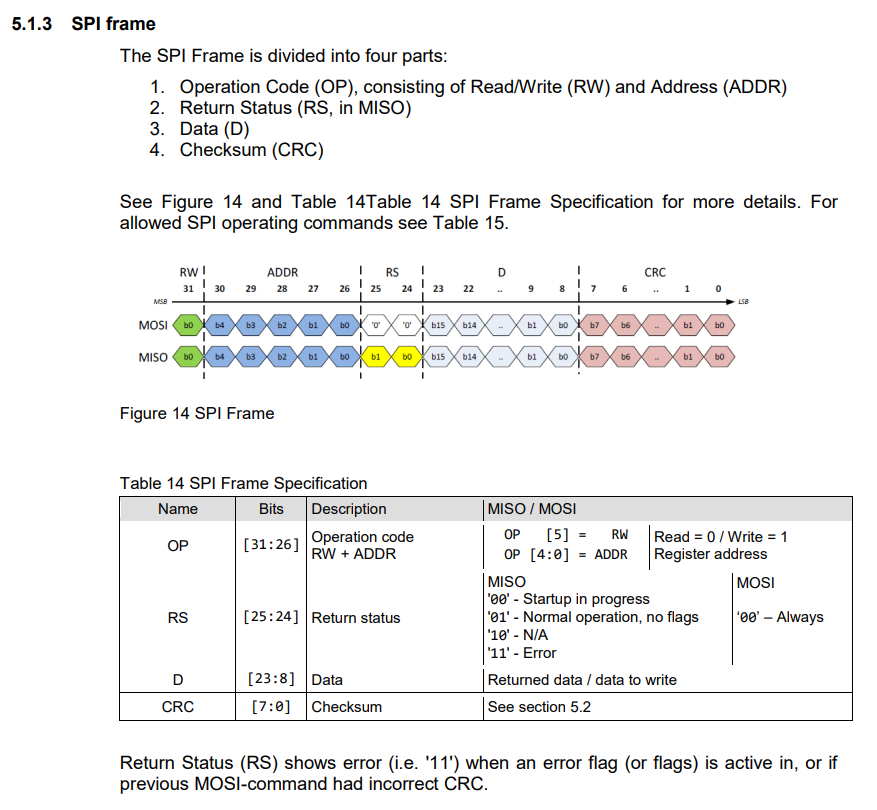

I think the problem will be in using the function HAL_SPI_TransmitReceive. The protocol needs to send 4 bytes and receive 4 bytes (see screens from the datasheet). In my case, I use this code:
for (int i = 3; i >= 0; i--) {
tx_data[0] = dataorig.bit8[i];
status = HAL_SPI_TransmitReceive(&hspi2, tx_data, rx_data, 1, 100);
dataorig.bit8[i] = rx_data[0];
The first parameter read OK (for example TiltX), but the second is invalid (e.g. TiltY). I think, there is a collision in the data flow. Is there any description of the function HAL_SPI_TransmitReceive?
0693W00000Y6vtaQAB.png0693W00000Y6vtzQAB.pngThank you. Tomas
The problem was in reading data. Responses are shifted as shown in the datasheet. The data reading code should look like this:
// first command
         transfer(RdAngX);
         if (crcerr || statuserr) errorflag = true;
// second command
	  transfer(RdAngY);
// response to the first command
	  angleX = (SCL3300_DATA / 16384.) * 90.;
// third command
	  transfer(RdAngZ);
// response to the second command
	  angleY = (SCL3300_DATA / 16384.) * 90.;
	  transfer(RdStatSum);
	  angleZ = (SCL3300_DATA / 16384.) * 90.;
	  transfer(Read_WHOAMI);
