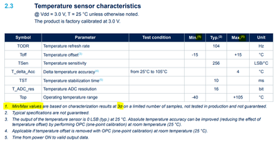

In the IIS3DWB datasheet, it is said that the embeddeed temperature sensor offset can vary within a [-15°C : +15°C] range.
Does that mean that the reading from OUT_TEMP_H/L can vary within [-256*15 LSB : +256*15 LSB] at 25°C ?
Having tested 2 chips myself, I got a much better result.
I am then wondering whether I was just lucky, and if I really need to calibrate.
Thanks

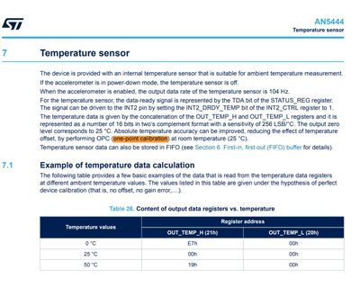

I suggest you to perform a one-point calibration to increase the accuracy of your sensor as mentioned in the datasheet. You can take a look at this exemple:
After that, you can see that the accuracy of your system increase.
Best regards.

Mind the footnote which explains what min/max means here. 3σ is a wide bin, and most of the time you're going to be in the middle third (so ± 5° C). And 0.3% of samples will be outside of that bin, so no guarantee you'll even be within that range.
Also note that even after calibration, you can have ± 4 °C over the full range. The focus of this chip is accel/gyro, not temperature.

The 2 chips I have tried are within 0.2°C (probably from a same lot), but I looked closer and their offsets are approximately -2.5°C, and I cannot afford that much.
I think I was in denial, hopping for an error in the datasheet, as ±15°C looked very big to me. It could have been ± 15LSB instead...
I guess I will have to calibrate then, it is a shame ST does not do it for us.

Otherwise, you need to implement an OPC at room temperature (25 °C).

Our devices with 6kHz bandwidth have a temperature offset min-max of ±15DegC, however, as suggested by @TDK , if ±2.5DegC is too much, you should choose a dedicated temperature sensor.
