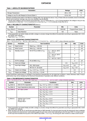

May be I didn't phrase that correctly, I mean: how much is the input capacitance of the SDA and SCL pins themselves at IIS2DLPC?
for example, here is the spec for an eeprom:

Reserved means secret? if yes: now can we calculate the proper value of the pullup resistors then?
https://www.ti.com/lit/an/slva689/slva689.pdf?ts=1689302761718&ref_url=https%253A%252F%252Fwww.google.com%252F
in p.2 is clearly stated that the necessary resistance is a function of the capacitance of the bus, then we need to consider every capacitance in the bus, we need to know the value of the input capacitance of every chip in that bus!
