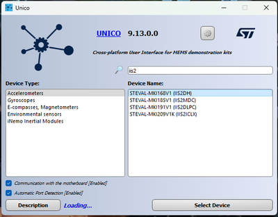

Hi Andreas @afr_e2 ,
may I ask you which sensor did you select in Unico?

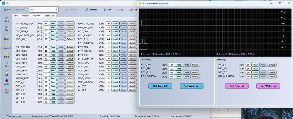

Hi Niccolò,
I have selected the IIS2DH.
My Unico-Iinstallation is
GUI-Version: 9.13.0.0
Firmware-Version: V3.6.26
Demonstration kit selected: STEVAL-MKI168V1 (IIS2DH)
Board: ProfiMEMSTool
As far as I understay the Datasheet, in this case there should be no difference to the LIS2DH. I just tested it with an LIS2DH device and have seen the same issue. So obviously we've always had the problem, it just hasn't been identified yet. :see_no_evil_monkey:

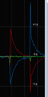

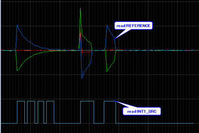

The Interrupt view from unico software shows, that the acceleration values are smoothed. If a movement is detected, the acceleration values rise sharply and then fall in an e - function. As long as this value is above the threshold, interrupts are triggered.
If the REFERENCE register is read out, the mean value is apparently reset. In addition, reading and resetting the INT1_SRC seems to be related to the sampling rate (ODR config). This would also explain why the register can be read multiple times without the line being reset.

Hi Niccolò,
thanks for your response. When reading the INT1_SRC register, the IA bit still keeps set and the INT1-Line also keeps high. After a short delay, the INT1-Line will go low. I assume, that the delay depends on the settings in the ODR. Is that correct?
I tried out to play with the INT1_DURATION. What I have seen is a delay between the movement and the INT1-Line, when increasing the DURATION. But this doesn't fix the issue.
If reading the REFERENCE resets the filter, this would be a possible way to handle with that phenomen.
Thanks in advance for your assistance.

did you try to disable the High Pass filter?
if you look at the data, it is normal that the interrupt returns high (if the interrupt is the light blue line, and if the threshold is low enough) because the data is high enough to trigger the interrupt ( can't be sure without the scale, but it seems that way)
