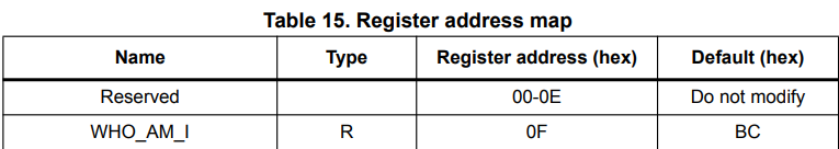

Hi all, I have been trying to read any data from HTS221 on extension board, and HAL I2C functions returns error.
I try to read WHO_AM_I register but HAL_I2C_Memread function always returns timeout so error. Any suggestion would be appreciated, thanks.
The simplest code to read WHO_AM_I register below
