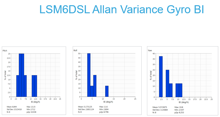

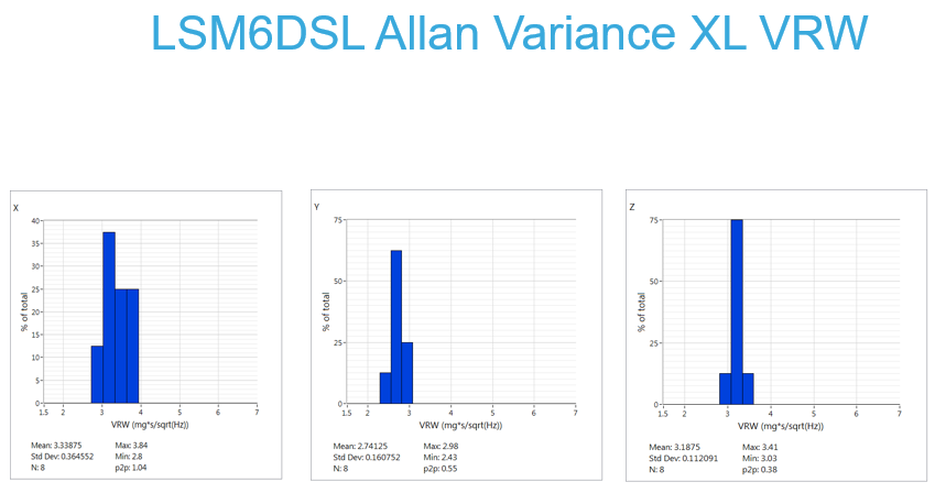

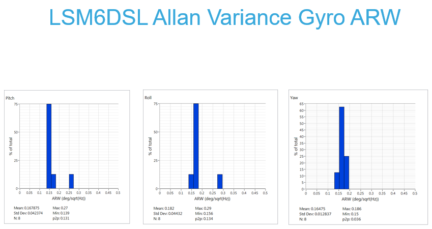

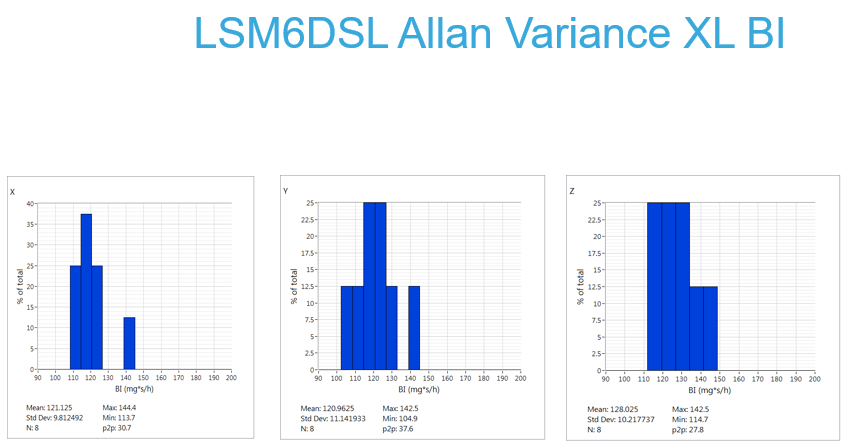

HI @SM.4 , the datasheet values usually refer to the parameter tested in production line
1. Bias Random Walk Noise standard deviation of Accelerometer & Gyroscope
I believe you are referring to Angular / Velocity random walk and Bias Instability. In this case, you can find characterization values here below, for both Accelerometer and Gyro

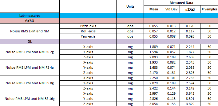

3. Measurement noise standard deviation of Accelerometer & Gyroscope
You can find here below some characterization data on N.50 samples
