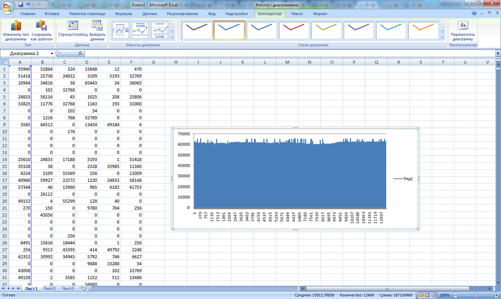

On all channels, data jumps from 0 to ~ 60000, although the accelerometer is at rest.

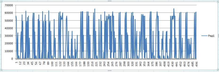

For example, X axys of gyro:0690X0000060QcxQAE.png

ooo,
you have negative numbers
+ and - 0
like this:
5,4,3,2,1,0,0xffff,0xfffe these are negative numbers just next to zero
I am working on the LIS3DE today, same negative numbers

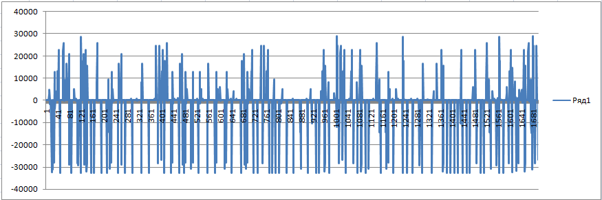

Well, if we take into account the negative values, then the amplitudes are still large (although the accelerometer is stationary)0690X0000060RHNQA2.png
T J
Lead
do you have the bytes swapped ?
