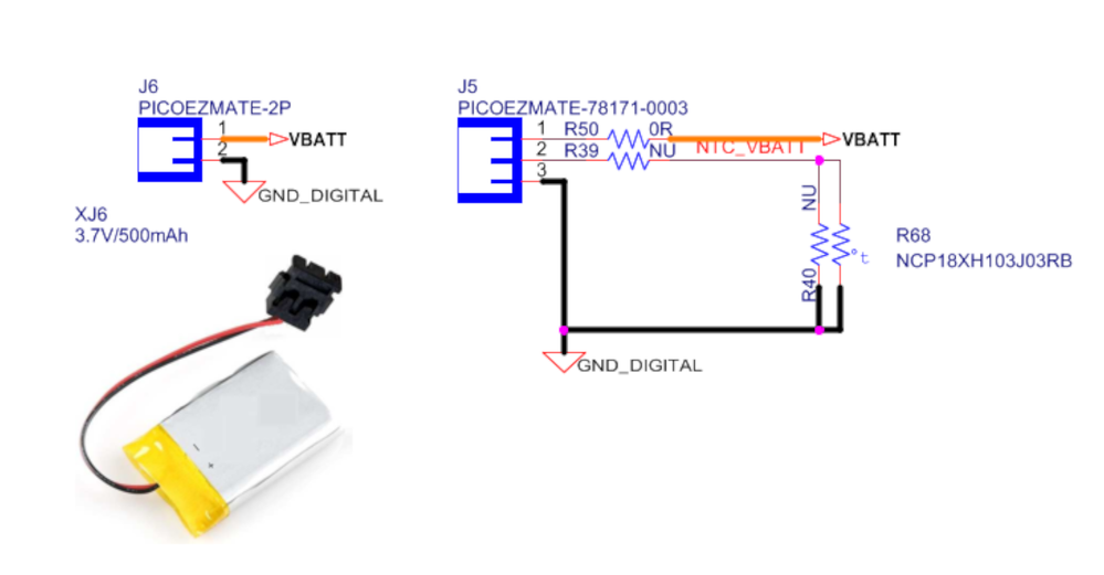

Thank you for the response . I had to search a little. I hope i have figured out the correct part number . Kindly validate (https://www.mouser.in/ProductDetail/Molex/36920-0201/?qs=T3oQrply3y99comCyd%2FYyA%3D%3D) if I have located the correct part.

Hi @SGupt.4 ,
Ya, those cable and connector are not the most robust ones on the market...
You can find the complete BOM on the STEVAL-MKSBOX1V1 CAD resources webpage, at this link.
In particular, you should check the 2-pole molex connector J6 (78171-0002) and the corresponding connector (78172-0002) from battery side.
Please let me know if you can easily find them and, if this is the case, please click on Select as Best at the bottom of this post. This will help other users with the same issue to find the answer faster.
-Eleon

Hi @SGupt.4 ,
this is the right one, thank you for having shared your search!
-Eleon

Thanks for identifying the cable and connector. Good call on checking the BOM. Just for additional information, I also found the part number on page 2 of the sensor tile box schematic.
