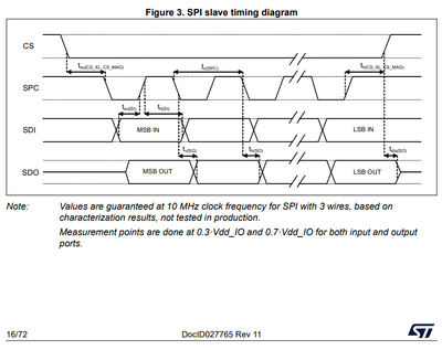

PS:
Did you look at the software ST provides:
https://www.st.com/en/mems-and-sensors/lsm303agr.html#tools-software
The datasheet shows a four-wire interface:
https://www.st.com/resource/en/datasheet/lsm303agr.pdf#page=16
