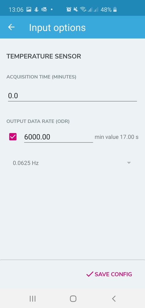

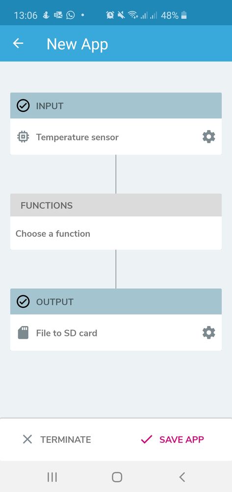

Btw, for your purposes you can use Mode 2 programming (Expert view) the temperature acquisition with the lowest ODR, saving data on the SD card. For a fully-charged battery, the optimized app (lowest temperature sensor ODR, SD card written once every long time intervals) will last up to 2 weeks.
