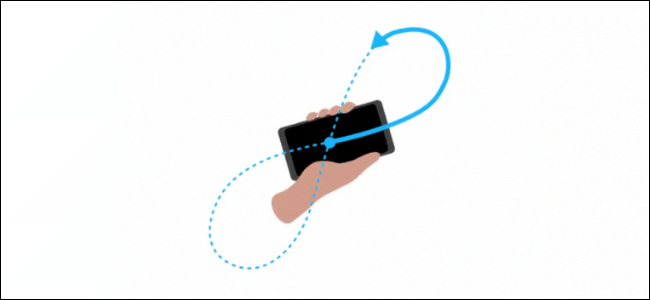

Hi @RZHU.1 ,
it could be the case... the suggested movement for the magnetometer calibration is on the 3 axis, for example as depicted below.
However, this complete calibration can be run at the beginning of the test, and the periodical calibration during the test can be avoided.
-Eleon

Thanks for your suggestion, I have changed my code and now it will only calibrate the magnetometer during the initialization stage, and the result of calibration is MMC_CALQSTATUSGOOD.
