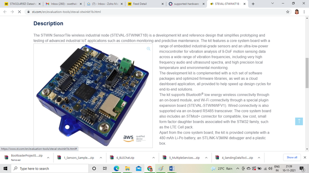

2021-11-10 8:11 AM
Hi @Eleon BORLINI Whether STEVAL-STWINKT1 supports BlueVoice, Is there is any comaprision between STEVAL - MKSBOX1V1 Vs STEVAL-STWINKT1
2021-11-12 7:21 AM
Hi @Snara.2 ,
I'm afraid that the BlueVoice library is not (officially) supported by the STEVAL-STWINKT1B.
Especially if the business behind is not negligible, you might try opening a ticket in the OLS page, asking for a custom firmware package.
-Eleon
