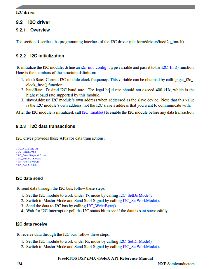

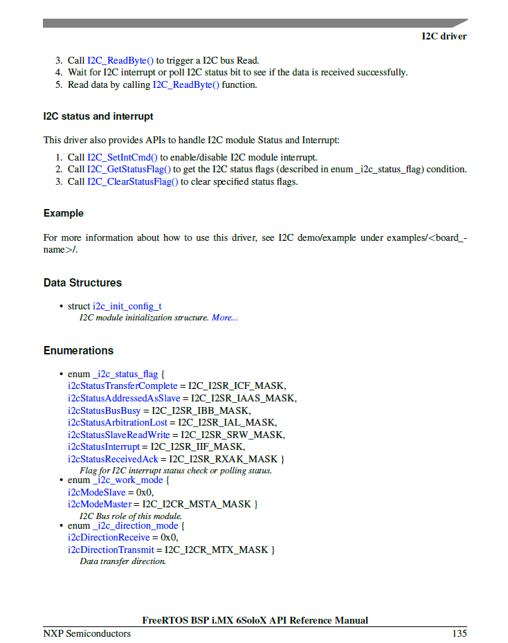

Thanks for answering. I see clearly the stuff I have to do, but I don't find any example helping me to develop the expected function. I've just found the API reference manual for the freertos BSP of i.MX6SoloX :
2017-06-21 9:55 AM
That is a good step!
As I wrote above, I would focus on three things:
1) I2C initialization: that is exactly what you pasted in the reference manual in section 9.2.2
2) Read multiple bytes: that is just about writing a cycle to send more bytes via I2C_ReadByte as stated in section 9.2.3
3) Write multiple bytes: the same as for 2) using I2C_WriteByte
