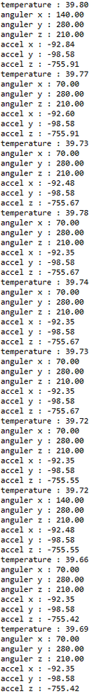

Sorry, but I have one more question.
I had success implementing it on other platforms using PID.
But I don't know if this is the right value.
I used the lsm6dso32x_offset example of PID.
The picture below is when the board with IMU is stationary.
Are these values ​​correct?
