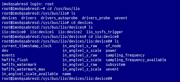

0693W00000ANUmLQAX.pngI use ASM330LHH as Linux IIO.
Source and DTS were added.
We found that /sys/bus/iio also added a device.
I also checked reading data in direct mode from sysfs.
Therefore, I think there is no problem with the H/W connection.
I want to use Trigger mode to read multiple data, but I don't see trigger and buffer in Directory.
I tried the # echo 0> /sys/devices/iio_sysfs_trigger/add_trigger command, but I still don't see trigger.
