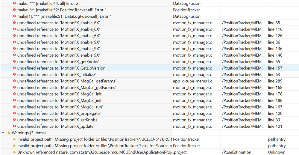

excuse me for not getting back to you sooner, but I want to calibrate the sensors before, as you suggested. However, I can't create a new working project with motion_AC and motion_FX together. I explain: I followed the instructions written in "Getting started with the STMicroelectronics X-CUBE-MEMS1 software package for STM32CubeMX", which is a document that I found in x-cube-mems1 expansion software; I created a new project with cube-mx, I selected Motion_AC and Motion_FX, IKS01A2 board support package and DataLogFusion application base as additional software; then I configured all the peripheral properly. When I compiled the generated software (which is not modified, so it is equal to DataLogFusion example, which use only motion FX library), some errors occured. In particolar, the functions of the motion fx library are not found. I tried to configure the project's properties as similar as the application example but the result was still negative.
I use STM32cubeIDE as IDE. I attached the file .ioc for cubeMX. In the following picture, the errorsare shown; in this case, the project has just been generated by cube mx:0693W000001sA7YQAU.png
Could you help me, please?
