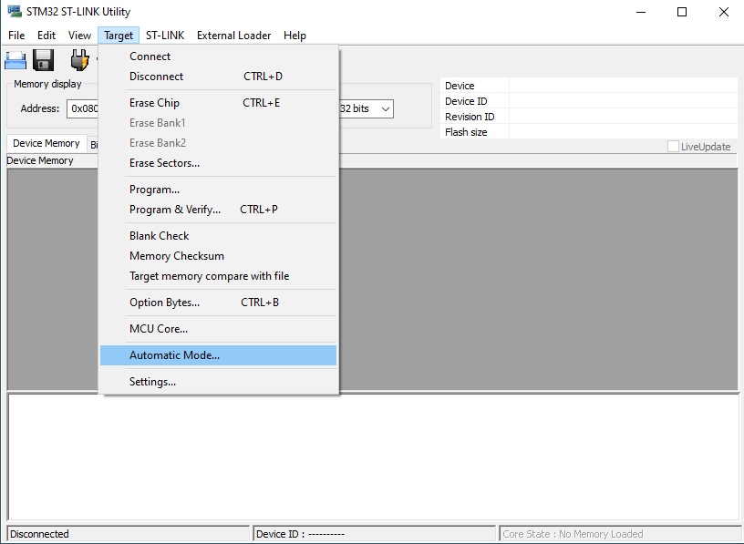

You can try running the “Full Chip Erase�? in automatic mode, as shown in the pictures below:
Just after having launched it, you unplug and then plug immediately the USB supply of the Sensortile.
The purpose is to make the ST-Link blocking the STM32 before the code execution starts. This procedure should lead to the reset of the STM32 chip.
-Eleon
