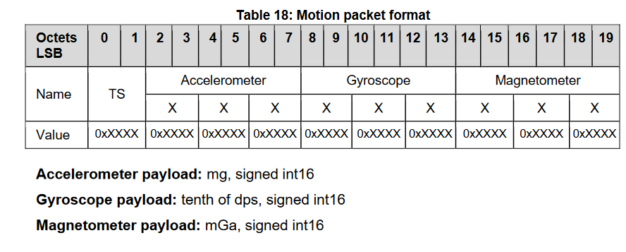

We are connecting the "00E00000-0001-11E1-AC36-0002A5D5C51B" characteristic which is an aggregate of the movement sensors. It follows this form:
(2) Read in the data:
X = read(chr)';
% where:
X' = [73 4 246 255 156 3 182 1 214 255 136 1 18 254 30 0 201 254 194 1](3) As you can see in the figure above, we need to access Bytes 2-7 for the accelerometer, and convert from the native unsigned 8-bit integers ("unit8") that MATLAB reads in, to signed 16-bit integers ("int16"):

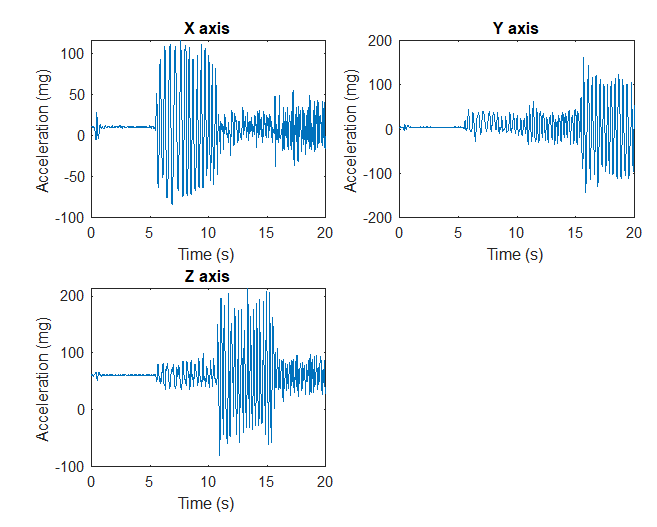

XYZ = double(typecast(uint8(X(3:8)),'int16'));(4) Finally, convert to engineering units, following the formula helpfully sourced in the comment by Eleon, above:
XYZ = (XYZ.*61)/1000;You can see the output below:
Good luck!

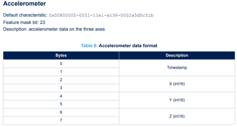

(2) Thanks for tracking down the conversion - I understand this will take a 16 bit integer and convert it into the physical units of the sensor. However, I am still stuck with regards to how I reconstruct the 16 bit integer from the raw data that I read from the device.
I read in the data with the above characteristics:
device = ble('WeSU');
chr = characteristic(device,"00000000-0001-11E1-9AB4-0002A5D5C51B","00000080-0001-11E1-AC36-0002A5D5C51B");
X = read(chr)';This yields a 20x1 double. e.g.:
X = [ 85 15 139 217 82 63 41 148 214 190 87 167 170 190 251 70 63 62 0 0];However, table 6 you sent above makes me expect a vector of 7x1.
his is where I am stuck - how do I convert this into the correct format. I figure this list is a set of 8 bit integers that I should convert to 16 bit integers, using MATLABs typecast function which converts from uint8 to uint16 by parsing the vector in pairs:
ACC= double(typecast(uint8(X(bInts)),'uint16'));This however isn't yielding any sensible output that conforms to movement - I figure I am reading something in the wrong order?
