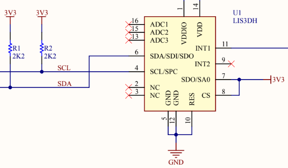

I need to communicate by I2C my board that contains the LIS3DH accelerometer with the MKI109V3 adapter board. In order to evaluate if the sensor readings are correct.
From what I understand, the MKI109V3 evaluation board allows communication via SPI and I2C. But, still not able to do it by I2C.
In my project I use the following signals:
SCL
SDA
While the signals:
SDO/SA0 (connected to 3V3)
CS (connected to 3V3)

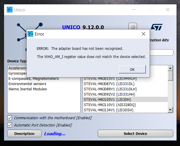

And I am using Unico-GUI software version 9.12.0.0
And I have the following response.
I would like to know what I have to do to establish I2C communication between my board (slave) and the MKI109V3 board (master).

Hi @Brian Rau ,
it is not possible, officially.
But well, there is indeed a workaround that you might use to overcome the issue of starting in SPI more. You can create a shortcut for Unico-GUI, adding in the Target (properties) the command -setcommi2c.
You can check whether it is working and see if this was the issue.
-Eleon

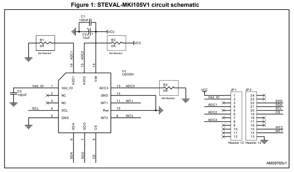

Hi @CVega.1 ,
My suggestion is to take inspiration (or copy) the schematic -or at least the connection- of the DIL24 adapter for the LIS3DH (STEVAL-MKI105V1).
In particular, I would leave the CS and the SDO/SA0 pins being driven by the Unico GUI.
-Eleon
2022-07-06 1:48 AM
For this project it is impossible, because the accelerometer communicates with other components through I2C and therefore I cannot modify the design.
Is it possible that the UNICO-GUI software allows the user to select the type of communication desired?
Is it possible to make any modification (hardware) on the MKI109v3 board to select I2C communication?
Is it possible to change some register in STM32F401VET6 to select I2C communication? And if so, how is it done?
I would greatly appreciate your help.
