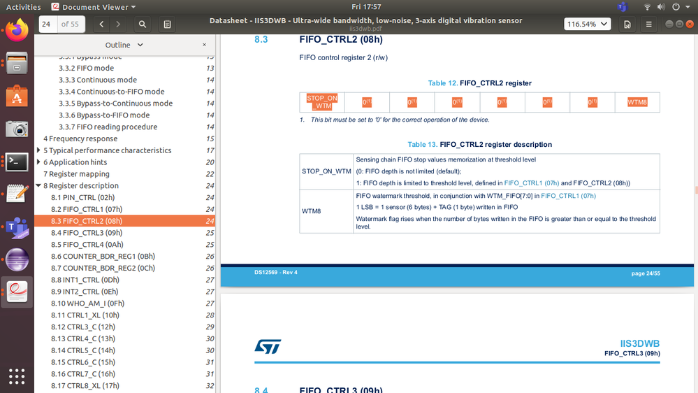

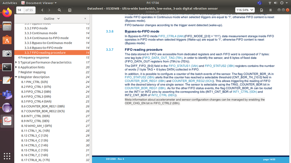

"Meta information about accelerometer and sensor configuration changes can be managed by enabling the ODR_CHG_EN bit in FIFO_CTRL2 (08h)". But , i have not found that bit in FIFO_CTRL2 register.

Hi @JPale , you have found a typo in the datasheet :) I believe this comes from other product datasheets such as the LSM6DSOX one, where in fact there is a ODRCHG_EN bit in FIFO_CTRL2 (08h) register that "enables ODR CHANGE virtual sensor to be batched in FIFO". I already notified your finding to our ST internal staff. Regards
