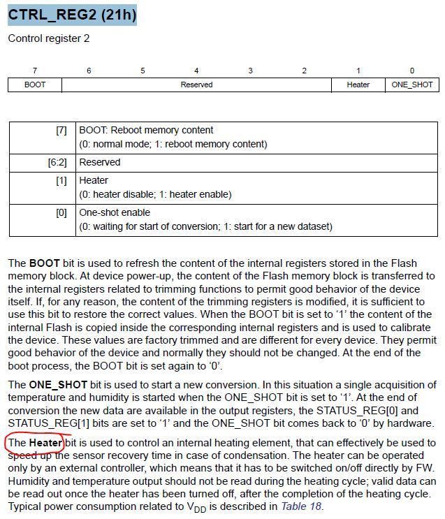

I guess the heater is to heat the sensing element and flush the humidity out. Monitoring the humidity and temperature should be possible while heater is on.... Normally datasheet will give you the operating range in temperature and humidity, so the answer could be it.

Monitoring the humidity and temperature should be possible while heater is on.... No.
The Heater bit is used to control an internal heating element, that can effectively be used to
speed up the sensor recovery time in case of condensation.
Humidity and temperature output should not be read during the heating cycle; valid data can
be read out once the heater has been turned off, after the completion of the heating cycle. (c) Datasheet.
Thought that ST would open the veil of secrecy.
I will try to turn it on periodically until the humidity readings stop dropping.
