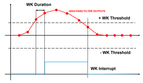

You are right: as reported in the AN5038 application note, when the duration time is set to zero, the wake-up interrupt signal is generated for each X,Y,Z data exceeding the configured threshold. This duration is the minimum available, and it means that, if the X data, sampled at a certain ODR, exceeds the threshold, the interrupt is risen "just after". This timing is equal to 1/ODR, as described in the figure 9 of p.21 (which refers to the configuration with 00h in WAKE_UP_DUR). In case you would set 01h in the WAKE_UP_DUR, the duration of the event will have to last at least 1/ODR (so, basically 2 data above threshold), and the notification will be risen after 2/ODR from the mechanical event threshold overcome, for each axis.
0693W000008wQm9QAE.pngFor your interest, the internal oscillator of the device (the master clock) is above 4MHz, so this is the maximum theoretical delay from a bit to the next one. But of course the bottle-neck at the output is the ODR granularity.

So, for a given wake-up event which happens some-when between two sample events, we have up to 1/ODR seconds of unknown error time between the movement event and when it was sampled, plus 1/ODR seconds (constant) until the Interrupt is raised. I'm ignoring the minuscule offset caused by the internal clock working at 4MHz.
Is that a fair statement?
Hi @APipm.1​ ,
ya, it is basically correct!
