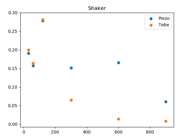

I found a lot of accelerometer that meet the specifications above, although I am not being able to understand how can I guarantee a good resolution in high frequencies of the accelerometer.
I already tested the MPU9250 in a shaker and the results in low frequency (until 150Hz) is reasonable, although in high frequencies (from 150Hz until 1kHz) it is horrible as shown below:
ps- the blue dots are the reference accelerometer (piezoeletric) and the orange dot is the MPU9250.

2019-11-21 3:16 AM
> - How can I understand from the datasheet that the resolution in high frequency will be ok?
Checking for frequency response parameters in the datasheet ?
The curve looks strange. There seems some resonance involved.
Unless you provide a reference signal (known acceleration), you cannot say which sensor is more off.
2019-11-21 11:51 AM
I tend to agree with your statement, althought there are some reasons why I believe in results above:
