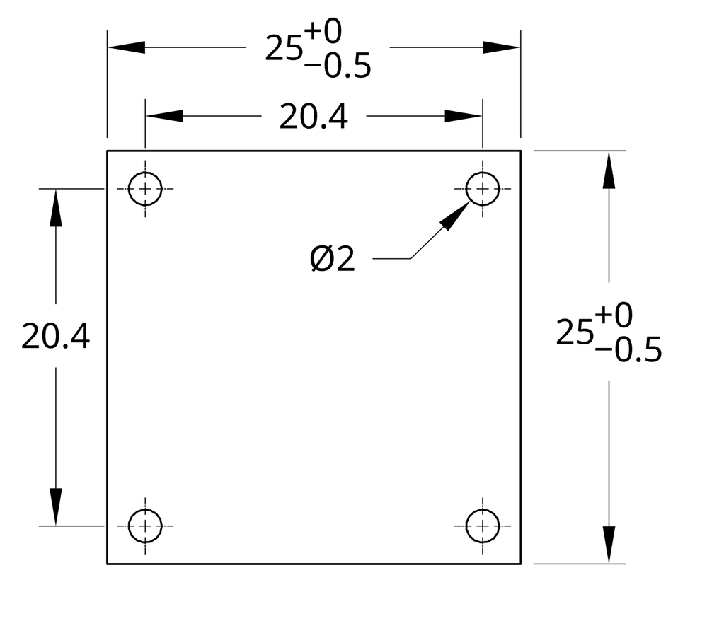

Thanks for the input! I don't believe you are correct about the hole location. The overall board dimensions are 24.5x24.5mm, but the gerber shows 20.4mm center-to-center for the holes (see attached screenshot). Furthermore, the holes are 3mm, which is a tight clearance for an M3 screw and a loose clearance for an M2.5.

Hi @kubark42 ,
I really don't understand the reason why the boards you mention have not same size we have discussed
Our normal plan is to do the same size for square boards and the size center hole to center hole is 20.4mm in both X and Y coordinates.
Concerning the size of the board, this is 25mm*25mm (+/-0.5mm depending the drilling machine). The size of the hole is 2mm as per STEVAL-MKI208V1 DRR file you find here:
3 mm is the metallization of the 2mm holes.
