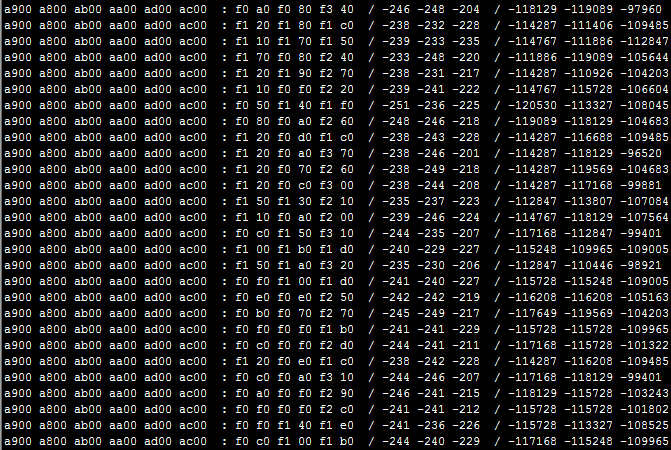

I'm using the H3LIS331DL accelerometer
to calculate the distance and velocity of a RC Car.I'm using the TI's Tiva MCU(TM4C123BH6PM, ARM Cortex-M4F series)
with 16MHz crystal.The connection between the sensor and the MCU is fine.
I'm using SPI interface with 1MHz SPI clock. The sensor returns the 'Who am I value' which is 0x32. In other words, the hardware connection is reliable./////////////////////////
The following pseudo code is the register setup I applied to the sensor.Write Control Register1 0x3F
Normal Mode, ODR 1000Hz with Low-pass filter cutoff Frequency 780HzWrite Control Register2 0x33
FDS = 1 (data from internal filter sent to output reg) High-Pass filter mode = Reference signal for filtering High pass filter enable for interrupt source bypass HPc = 64 (High-pass filter cutoff frequency config)Write Control Register4 0x80
BDU on FS bit = 00, Sensitivity = 49mg/digitWrite Reference Register 0x0f
The following pseudo code is about reading the X_High, X_Low, Y_High, Y_Low, Z_High and Z_Low.Read X_High, X_Low
signed short x = ((X_High<<8) | X_Low) >> 4 //Since the sensor follows the 12-bit representationdouble ax = x * 49 * 9.8 /1000;
//Same to y axis and z axisAs a result, the acceleration is shown as the following picture below.
I printed some data when the sensor is not moving. The data are six MOSI(MCU TX, read X_High, read Y_Low, read Y_High, read X_Low, read Z_High, read Z_Low, ), six MISO(MCU RX, value of X_High, X_Low, Y_High, Y_Low,Z_High, Z_Low,), three 12 bit representation value(X, Y, Z), and three 12 bit value times 49 times 9.8 (acceleration value X, Y, Z). I don't know how to print floating values on the terminal, so I didn't divided 1000.I think the values are not valid. Is there some changes to be needed to the sensor's control registers?
