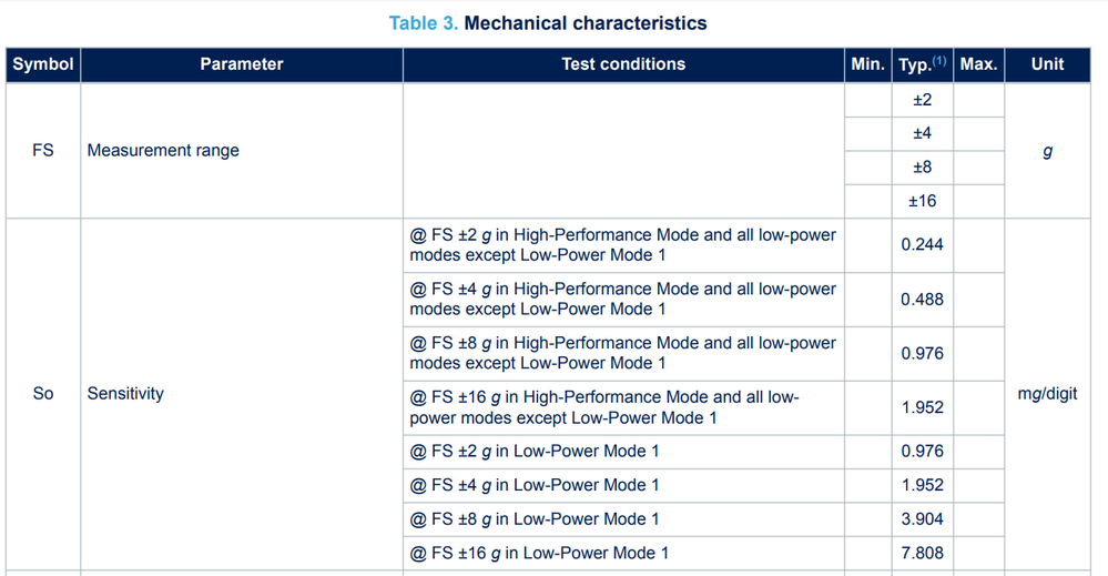

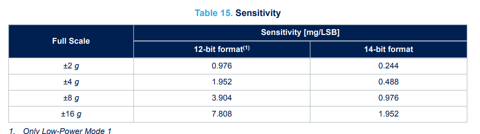

Hello @Eleon BORLINI,
I'm not sure where the value 0.061 come from. I can't find it in the datasheet or app note. What I can find are these values (in the datasheet):
And these others from the app note(which are the same):
Perhaps in the C driver there's some scaling? Could you please explain further, perhaps I'm missing something?

Hi @NEche.1 ,
since the data in the Github formulas, to convert from 16-bit to 14-bit you have to divide for 2^2 = 4, i.e. a shift left of two positions.
This is the same as:
float_t lis2dw12_from_fs2_to_mg(int16_t lsb)
return ((float_t)lsb) * 0.244f / 4;
