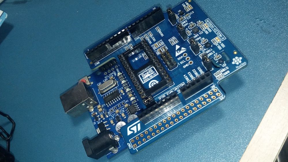

Thanks for the reply,I have connected the arduino uno board with
X-NUCLEO-IKS01A1 as shown in the image.I have also connected the board
X-NUCLEO-IKS01A1
for Vin as 5V.I have added pull up resisters too by giving 3.3V to SCL and SDA.But in arduino console I'm unable to see any output. Even I have tried in Intel edison too,the device address is not detecting.The codes I'm using to check is

Posted on June 23, 2017 at 16:34
all the jumpers should remain in position, as the schematics suggests. If you disconnect them, it disconnects power from them.
Please, read my comments above, one more time.
1) Make sure the sensors are powered with 1,9 - 3,6 V, not more! Otherwise they can be damaged. (Do you have a multimeter?)
2) There are already 4k7 pull-up resistors on the sensor board!
3) Do you have any instrument (logic analyzer etc.) to verify the sensors are working without the Arduino board?
