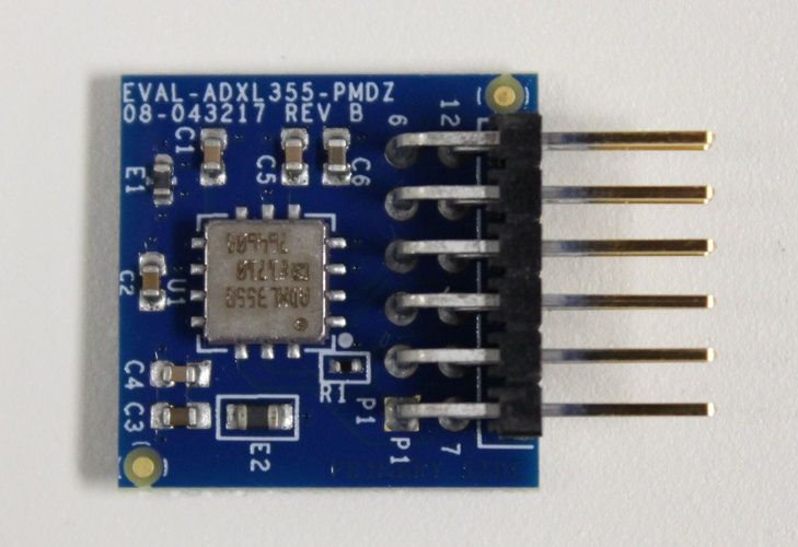

Hi everyone, I want to connect ADXL355 accelerometer sensor with stm32F407 mcu using I2C but, there is no any response from the sensor. Can anyone help me? Thanks...
