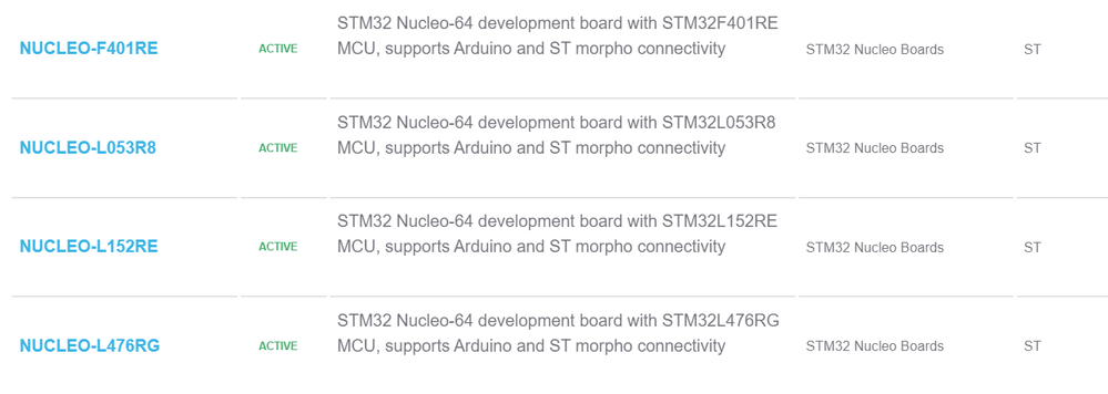

Hi, probably there is no predefined example with the NUCLEO-F303RE + IKS01A3, even if the two boards are compatible.
You might start from the FP-SNS-ALLMEMS1, where there is an example with an evaluation board with STM32 Cortex M4 (STM32F401RE-Nucleo). From this example, you can configure the peripherals for the interface with the IKS01A3 expansion. The Arduino R3 connector is the same across all Nucleo boards.
