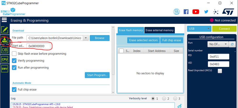

Hi Aditi Prakash @aditi1prakash ,
regarding the upload procedure (the request to start from memory address 0x08004000), try to use the STM32CubeProg tool by changing the start address in the field shown by the red circle in the picture below.
Regarding the second point, I'm afraid that the board must be restarted after firmware download, by unplugging the USB cable and/or by disconnecting the battery.

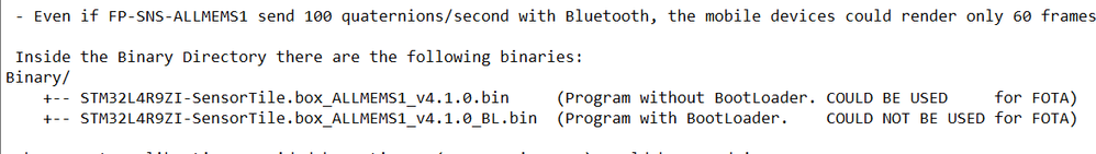

But my first question was, if it is possible to change the starting address from the Android app.
And, why is the binary with Bootloader not supported for FOTA?
Below is a snip from the readme.txt file of the project.
