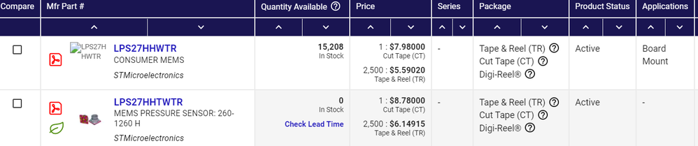

I've found these two parts in Digikey:
0693W00000UoAOXQA3.pngCan You please explain what's the difference between them?
Hi @SPodl.1​ ,
ok now I have understood the point.
There are two different "flavors" of the same pressure sensor:
The main difference is that in the LPS27HHTW the pressure sensor is equipped with an internal readable temperature sensor whose accuracy is ±1.5 °C. If you do not need this feature, the two devices are equivalent.
-Eleon
