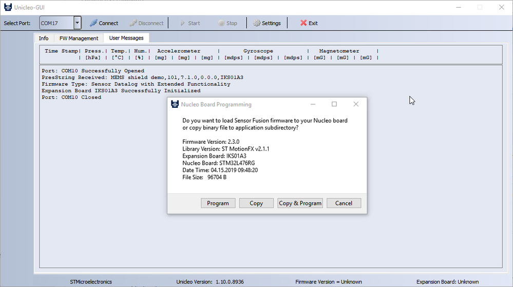

I draged and droped the binary file of iks0a3 from mems1 into L476RG board but i don't find anything in fw management
2019-11-05 5:20 AM
Drag and drop the binary file to Unicleo application.
2019-11-05 5:24 AM
How to get this message what should I do exactly
